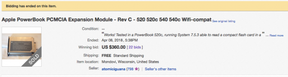

I've been working on piecing together 4 more 5xx series PowerBooks from various working/not-working machines I picked up a couple weeks ago. Three of them are working but for the fourth, it's a little flaky booting and I noticed the speaker was crackling non-stop after power on. I did smell something - it wasn't the usual fish smell from electrolytic caps but smelled more like ammonia? Not positive. It couldn't be the 1 logic board cap on these as I already replaced it with a brand new polymer capacitor. That's when I spotted:
(screen capture from @3lectr1cPPC 's MacDat site).
It's been staring at me the whole time but underneath the two purple plastic boxes are C110 and C111, both seem to be 68uF 20V capacitors. They are metal cans inside the plastic covers but not sure what they are made of. There was residue under both but I can't be sure whether that may have been from the original 100uF 25V capacitor next to them.
I pulled them off the board, one of the cans seemed to be bulging on the bottom (next to the pins). Off the board, one of them measured 65uF but the other was around 56uF. That would be at the edge of 20% tolerance and beyond 10% tolerance.
I replaced the lower capacitance one with another off a donor board. The system seems more stable and the crackling speaker seems to have gone away (although I don't have a large enough sample size).
cc: @croissantking
cc: @croissantking
