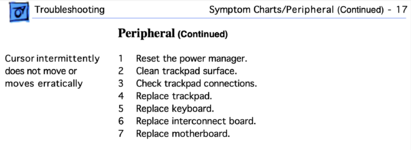

Troubleshooting Trackpad from the PowerBook 500 Series Service Manual.
by benefit of spare parts, i have done every step except #7. Trackpad completely unchanged, still twitchy.
(I don’t have another motherboard... so the nuclear option is off the table; sigh.)Screenshot 2023-05-24 at 4.24.36 PM.png
