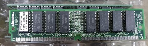

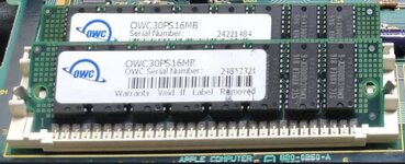

Connector pins are fine (and this card works if I remove the additional memory chips -- well it did last time).
I probably shouldn't... but cannot ... resist... (takes out another 16MB module from his working 5300c)
Why not try adding one extra bank first, for 24MB, and see if it works? Then you could see if the problem is one bank or the other.
Success!!! and wow, I just feel stupid right now. It was actually all good the first time I tried to do this, and it was good earlier today on my second attempt.
The issue was I have a Global Village modem card in there and after installing the memory card (since it now has chips on the side facing the modem card), it was shorting against the modem card... Argh!
These chips are the same thickness as the stock ones on the other side, I guess there isn't much room. I put a piece of mylar between the modem card and the memory card, and it works now.
