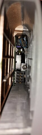

To use the external display mode the 520c has to be booted with the lid closed or be tricked into thinking the lid is closed. The screen latch pushes down a little switch that does this. You could just jam something in the latch slot to hold the switch down but since I had to take off the top panel to remove the display cable I used a piece of wire to hold the switch in the down position. I could have glued it or soldered in a jumper but this way I can just clip the wire off if I decide to get a new the screen assembly at some point.

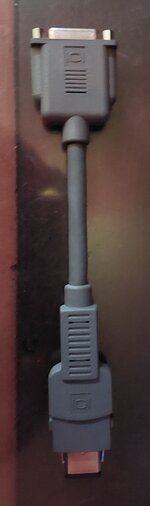

If you do this I would be careful with the external display port. The adapter is very bulky and inflexible and it seems like it puts a lot of stress on the port.
