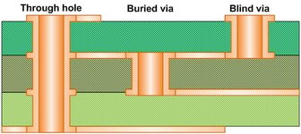

A via is a tiny hole in a multi layer circuit board connecting the top side with the bottom side
Or, as is the case here, some board are even multi layered (more than just the top and the bottom that you can see, but also circuits sandwiched inside the board, usually 4 or 6 layers - in this particular Powerbook 145 screen board I was talling about ; I think it's 3 layers)
Here's an example of a side view of a 4 layers (of copper) board. This is typical for anything from the Nineties.
And as an amateur, you basically can only repair vias that connect the top layer to the bottom one.
You can forget about repairing so called "blind vias"
Which is also why repairing laptops (and modern desktops) can come to a dead end, unlike repairing desktops from the 80s that you can repair with a hammer, have a single or dual layer board with confortbale spacing, and only use "off the shelf" components.
