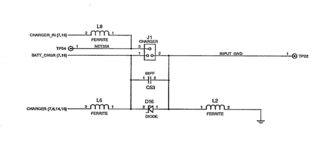

Hm. It sounds possibly like a grounding issue, or something is tripping ground detection... which diode did you replace with the IN4004?
It is a diode right behind the barrel connector, the D16 (same problem as this video:
). I think it serves to prevent wrong polarization of the power input. The replacement BTW is a 1N1007 (not a 1N1004 - not that it makes a lot of difference anyway). The original D16 might be a zener, the 1N1007 is not. Not sure if that will cause a problem. But I have no details on the original D16 to go from.

Ha, nope... I just had similar symptoms when I had a grounding issue in a 140, so it sounds familiar. You're right about the diode originally being a zener and present for reverse polarity protection... I have a vague memory though of a non-zener replacement possibly allowing reverse leakage, somehow - really not sure. I'm still learning these things. But that vague notion was behind my question about the diode replacement. I would be curious to know if the symptoms remain if you simply remove the diode.
The equivalent replacement is this dude: https://www.digikey.ca/en/products/detail/diodes-incorporated/DDZ13B-7/700105
Package is a little smaller, but can be made to fit.

It'll run without the diode:
