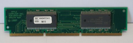

Incomplete List of ROM modules:
type-numbervoltagecomputer modelchipsspecial featuresreprogrammable
820-0961-A3.3V?4x AM29LV800unpopulated sop & plccyes?
820-0954-013.3VPM G32x KM2316205Y2x 70 pin chipsno
341-07585VPM 95008x HM27C4000FP-12no, OTP?
341-07575VPM 6/7/8100no
341-07415VPM 6/7/8100no
341-08335VANS 500/700no
820-0672-APF63x0ROM & Cacheno
333-1087PF62x0ROM & Cacheno
"Apple ESB ROM"ANS
"PEX proto ROM"5V?Power Express 970016x AM28F020prototype relatedyes

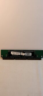

Greetings,
It has been a year since this was posted. I was curious if progress has been made with either the Todo or goals.
I have three DIMMs that appear to be the same as IMG_6823.jpg. I have a strong desire to duplicate/copy the contents
of one of the ROMs to one of the others. It would be great to have the ability to create additional copies if writeable
ROM DIMMs can be had. I had hoped that the ROM programmer I have from CayMac would accomplish this but the
ROMs are different.
Any info would be appreciated.
Thanks.
