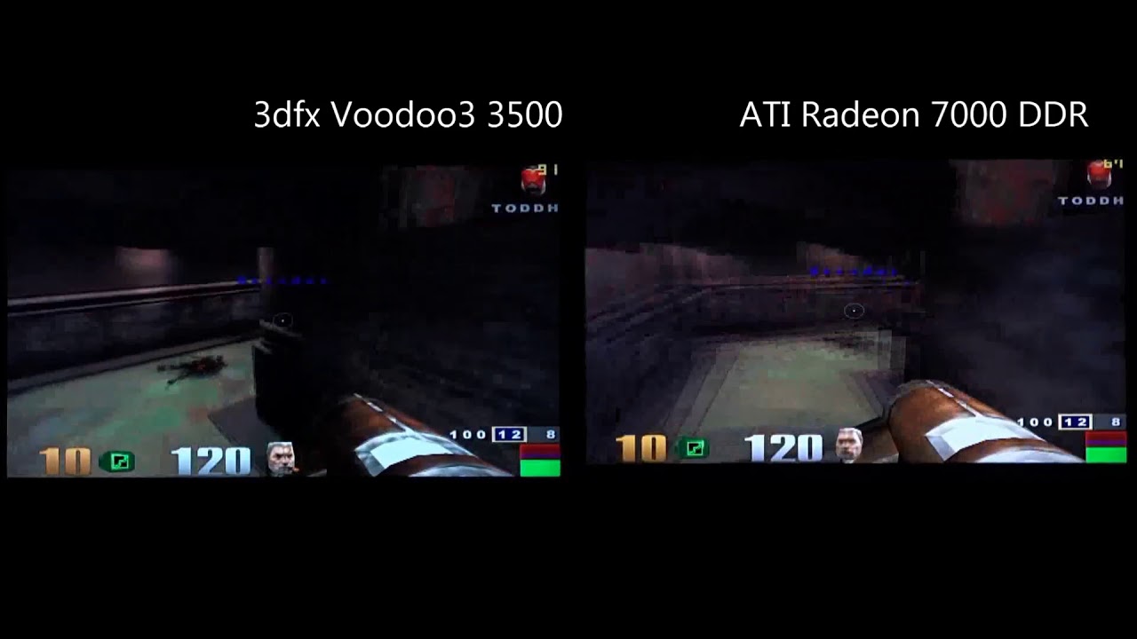

I know its not quite the same thing but I guess that one could use a voodoo2 card to basically do ati>3dfx>tube 'loop' internally? as even a more basic card like that still has some particular improvements over the onboard chip
I can't find the specific rage/voodoo one I know was out there but even then these two quick-to-find-from-web unrelated comparisons nevertheless shows my relative point regarding 3dfx;
