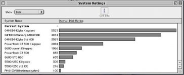

No questions asked mate... you'll be blown away - heres the benchmarks
See PoweBook G3 500mhz with spinner HDD (835) and Kingspec is mSATA adapter (2084).
