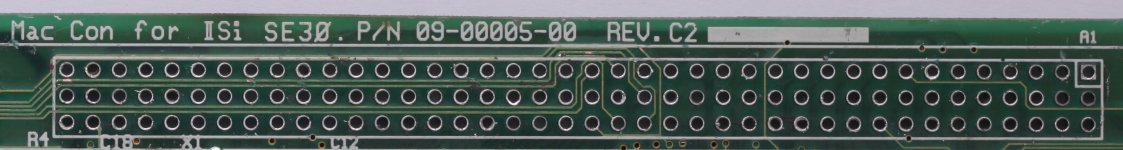

Here is another brainstorm topic if anyone has some comments into technical issues with this idea. I am trying to see if I can adapt the PDS pass-through slot on the Asante MacCon SE/30 / IIsi card that has the PDS slot going the wrong direction for the SE/30. Gamba outlined the issues here: http://home.earthlink.net/~gamba2/se30_pds_multiple.html#3cgs The solution relies on using a right angle euroDIN connector, but in a way not really intended by the connector and not very mechanically secure. I tried some effort in desoldering the connector, but I got frustrated with it, I may try again. But in the meantime I thought of making this:

Well, I think you've convinced me to try removing the connector again on the Asante NIC. Would you be able to describe the steps, such as desolder then bite into the connector, or desolder after? How far down do you have to bite down, can you get away with going down half way?
I was also thinking about cutting into it with Dremel cutting wheel and chopping it down to ~1/3 the height. The approach here is to try to free up the pins so they can be removed individually without being incased in the connector's plastic housing.

I'd desoldered every connection with a piston type Desoldering Iron. The connector just wouldn't budge overall, too many pins were still hanging up.
I started munching at it from the ends with the jaws of the nippers parallel to the pins, no upward pressure to speak of, just crushed the plastic housing with pressure from the sides. The pins were in shear, pulling them sideways for the most part, not under tension, pulling them straight up from the board wold have likely proved problematic at the PCB level.
Several pins stubbornly refused to let go, so I desoldered each individually after I was finished munching the connector to smithereens.
No damage to the board at all, no matter how scary that first picture looks.

It's getting closer! I used a Dremel with a cutting wheel attachment and side cutters to cut off remaining pieces. There was a bunch of chip-quick that got into the connector that made a molten mess as I cut into it, so there's still a little bit of cleaning left to do. I don't think anything got damaged though.
That's lookin' really good, tt. Best of luck with the rest of the conversion.
I'm cheating, I'm converting one of the Radius Color Pivot II/IIsi Boards for now. :o)
Getting even closer:
Pins clear with an incorrectly gendered EuroDIN connector I happen to have and the card still works!! So I am ready to solder a connector once I have one. :D
