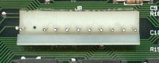

Does anyone know the part number for the plug that connects the early logic boards to the analog board cable?
Also, does anyone know the part number of the socket that is mounted to the board (the one in the picture)?
Thanks in advance.
I don't know, but you can measure the spacing between pins, then search on DigiKey. You'll probably need to buy the connector housing separately from the crimp terminals that go in it.
Maybe this? http://www.digikey.com/product-detail/en/09-50-3111/WM2109-ND/26471
I think that's the part number for the housing on the cable.  It looks like this is the part number (link) for the connector on the circuit board:
http://www.digikey.com/product-detail/en/26-60-4110/WM4629-ND/193997
It's always good to scroll down in Digikey's listing to the "mating products" and "Associated products".  That will get you the housings that mate and the pins that go in empty housings.
