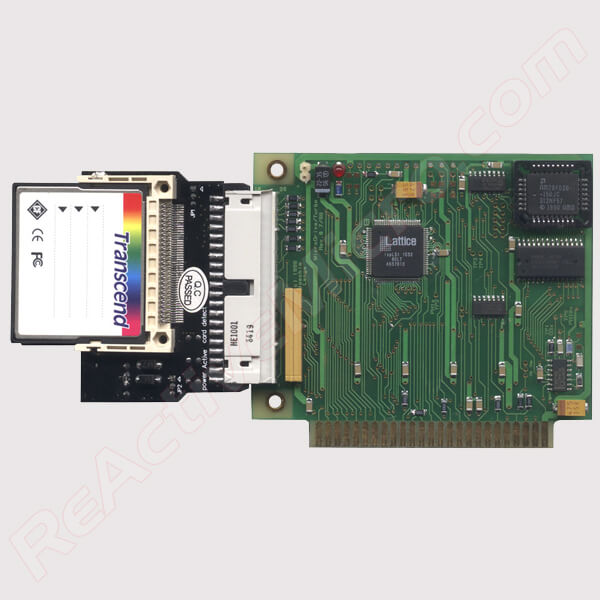

I've a largely stock enhanced Apple IIe that I'd like to add a SmartPort SD/CF boot device to, I've the Disk II card, Floppy Emu (but usually use this on my Macs, so probably not the best option). There are a lot of homebrew projects around however I'd be keen for a kit or affordable basic card - anyone have any tips or recommendations?
These are the ones I've found - limitations on price and current available of parts
ReactiveMicro Drive turbo (in stock, old design, ?not SmartPort compatible?, my best option?)
www.reactivemicro.com

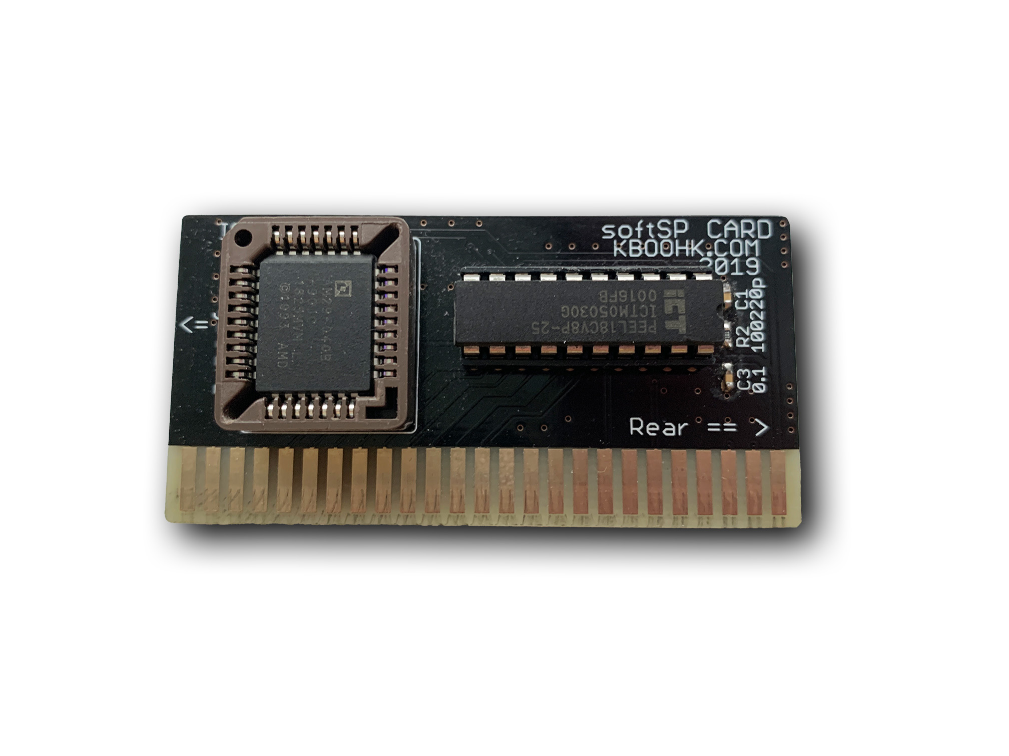

SoftFP card - has some caveats for use with a Floppy Emu (and I probably won't use the Floppy Emu much)
ct6502.org

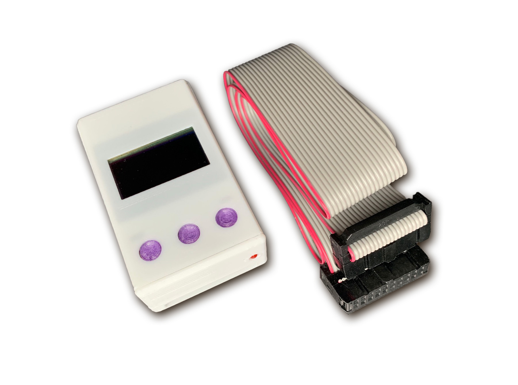

wDrive emulator (no SmartPort support unless you use the above ROM patch card)
ct6502.org

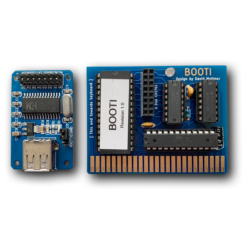

Booti - perfect, but out of stock
ct6502.org
ReActiveMicro Drive/Turbo for II, II+, IIe, and IIgs
NOTE: If you use your own CF Card you must confirm it complies to the original CF standard. If not it may not be compatible. And most manufactures no longer state revision compliance. Testing may be t
Apple II MFA2 SoftSP Card wDrive or FujiNet - CT6502
The SoftSP card is an add-on to the wDrive, and allows you to boot hard disk images (2mg and hdv) on an Apple IIe, which does not have SmartPort support.
Apple II wDrive Disk Drive Emulator - CT6502
The wDrive is a disk drive emulator for the Apple II (II+, IIe, IIc, IIGS) that boots disk images (WOZ, DSK, 2MG, HDV, etc) from an SD card.
Apple II BOOTI USB Hard Drive Emulator Card - PERMANENTLY OUT OF STOCK - CT6502
The BOOTI card is a hard drive emulator that allows you to mount up to 8 disk images in any Apple II (II, II+, original or enhanced IIe, and IIgs).
