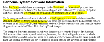

7.1.2 was created to introduce the PPC line; separately, 7.1.2P was released -- and oddly, it wasn't just released for Performas -- it was released for the Quadra/LC 630 series as well. The documentation seems mixed on this; sometimes it says that 7.1.2P was for Performas and 7.1.2 was for PPC and for Quadras -- but the actual build/restore images and DevCDs all had the Quadras getting 7.1.2P.
