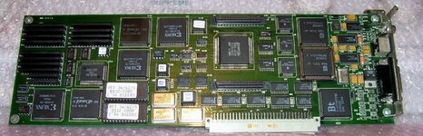

Looking for original drivers for NuBus RasterOps 24STV card, running on Quadra 650 with System 7.1
Allready tried:
RasterOps Graphics Install v3.2
RasterOps Graphics Install v3.3 - 1994
MoviePak - Disk 1 - Disk 2 - Disk 3
MoviePak2 - Disk 1 - Disk 2 - Disk 3
VideoTime - Disk 1 - Disk 2 - Disk 3
RasterOps Monitor extension v1.53 - 1990
The card can grab a video source and is recognised by control panel but the video is not accelerated. Norton speed test result the video speed as on Mac LC.
I have found out that I need RasterOps Monitor Extension control panel Ver. 1.65 so does anybody have that version of drivers? Thanks

Well I found out the card is not accelerated so any Raterops drivers works just fine with this card but the card is just slow. You can accelerate the card with additional nubus Rasterops Accelerator I or II but when capturing the video acceleration is recommended to be OFF.

I'm curious if you tried RasterOps Graphics System Software v1.68 here:
I don't have the same card as you, but I do have a RasterOps 24Sx and the 3.0.2 Accelerator Control Panel will turn acceleration on/off (Other versions of that control panel did not work).

So I should save 50€ by not buying one. 😅
