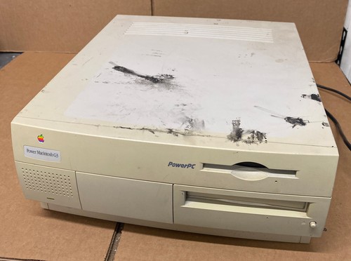

After getting a taste of a 68k system through my Cenrtis 650, I decided to pick up a beige G3 desktop. Here is the eBay listing I purchased the machine from.
I purchased this machine because the seller offered to pay for return shipping.

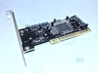

I did a quick eBay search for "mac pci sata" and found two promising results.
This is a four port SATA card.
This is a two port SATA card.
The four port model is cheaper. Maybe I could get that plus one SSD drive and I would be good to go?
Don't get the 4 port, it doesn't work in OS9. There isn't a rom available.
Interesting there are flashed cards available again.
It is a lot cheaper to flash your own from a windows card. It can sometimes be done with just software, other times it needs some PLCC soldering, depending on what chip the card has.
Like Phipli mentioned, the SiI3114 based four port cards don't have a ROM available with a Classic Mac OS driver in it. The SiI3112 SeriTek ROM, which dosdude1 recently modified to be able to fit on the EEPROMs already on these cards, includes one that allows you to use SATA drives all the way down to System 7. It presents itself as a SCSI device to Classic Mac OS, as those operating systems have no concept of SATA of course.
The 4-port listing only specifies it works in X. The other one lists both 9 & X. If you're willing to pay that much maybe you should ask @aperezbios if the new SATA card is available to buy yet. No idea how much it will be but they're very nice. Can even use an m.2 SATA drive on it!
