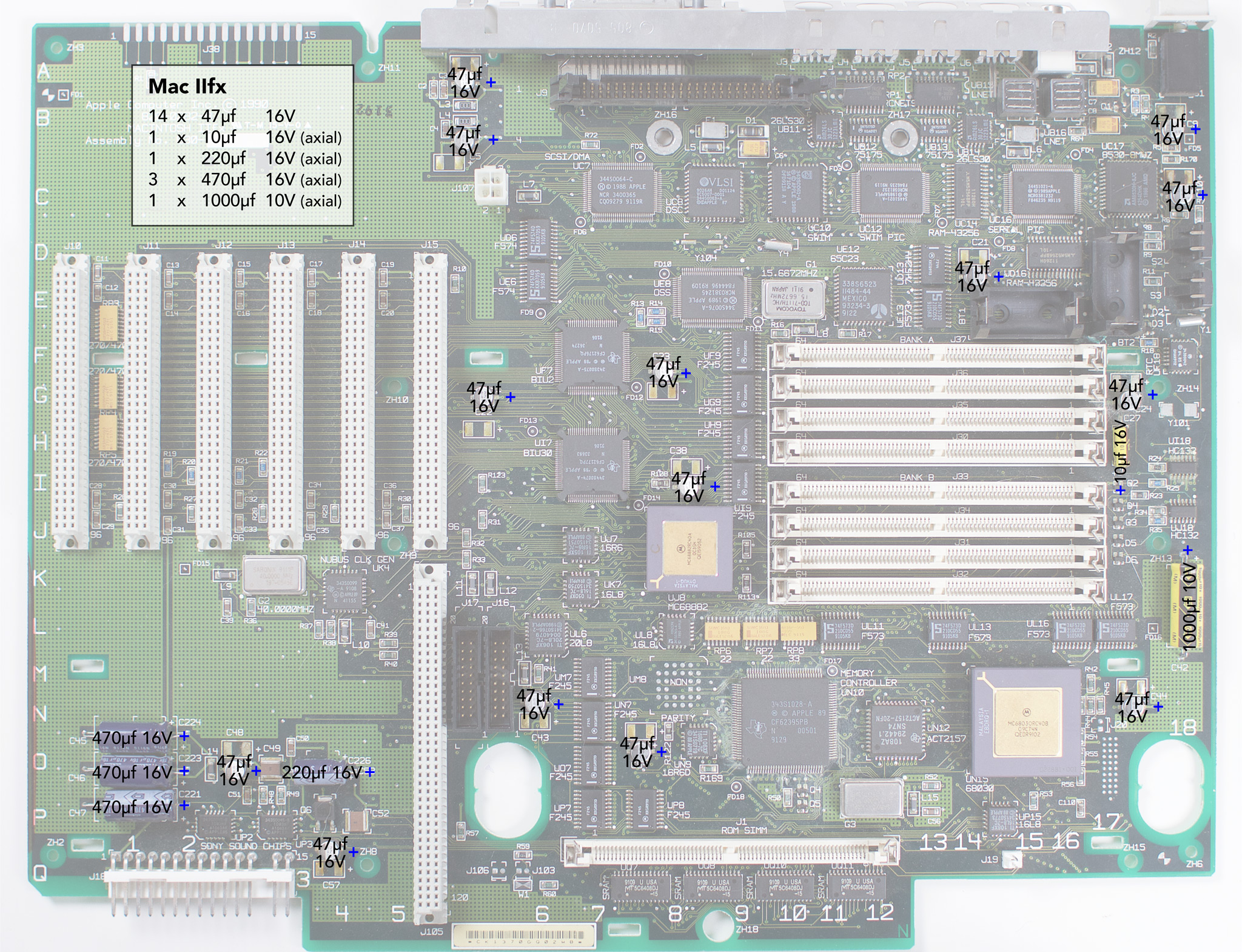

I have a brand new MacIIfx logic board. I assume I should recap this as well? Any suggestions or recommendations?

If the machine doesn't want to shut down replace C24 and C9 which are the only leaky SMT capacitors on the board. The larger capacitors rarely if ever need changed and the tants will blow up if they need replaced (they short closed and pop generally not hurting anything in the process).
Is this a NOS board? Yeah, C9 and C24 should be replaced. Someone mentioned C1 blew in theirs and left a small crater. The original is spec’d to 16V but as recent info suggests with these tantalums, they need to be spec’d to double the voltage they will be used for. In this case I believe C1 is on 12V so instead of a 16V, you should replace it with a 25V rated one (47uf). I just replaced the axials too while I was at it.
Thanks for the tip about C1. I had a C1 blow, the original tantalum, fortunately just damage to the capacitor. I'll upgrade it to a 25V.
