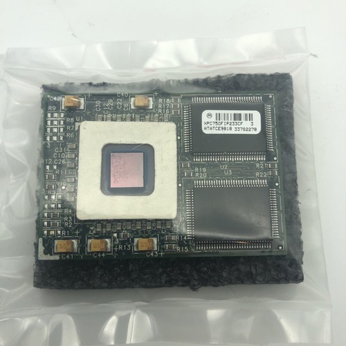

And since @Phipli puts bad ideas in my head, is this the right G3 proc upgrade? ;) Figured should probably do before the fresh OS install if I can pull it off.
Thanks!
That isn't a G3 upgrade, that's just a bottom end processor from a Beige G3.
None of the computers you named have a ZIF socket it would fit. Which machine are you wanting to upgrade?

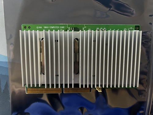

I liked your suggestion to upgrade the 7500/100, however my memory was off. You suggested a 604e 233, not a G3. So I think this is what I actually need then?
Here's a picture of the current proc card
Thx!
Right sort of thing, but that one is special because it is from a clone.
There is a cheaper 200MHz one available, but it is labelled as 9600 only, which is a surprise as I understood the 200MHz boards to be universal. I'm caught out by that, especially as I have an almost identical board that isn't labelled as 9600 only.

Yeah that 233mhz Umax card is probably as good a deal as you’re gonna get in terms of price/performance. The third party g3/g4 cards are usually 5-10 times more expensive.
