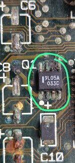

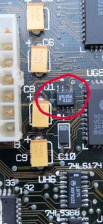

I got a macintosh classic a while ago and it was working before showing issues so I recapped it. Before the issues, I noticed that the sound wasn't working from mac or headphones. While I was recapping, I noticed a chip (mc9l05a 033c) has its legs quite corroded and looks like it needs to be replaced. Would it possible to find the same chip somewhere or get a different chip that would be replacement. If those options aren't available, please let me know. Would it also be possible to find what is causing sound to not work and find a solution for it? Thanks.
After recap and cleaning:
Before recap and cleaning:
