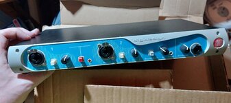

I bought power Mac g4 with this card installed. Looking Altera flex card gave me multiple results but not this exact one.

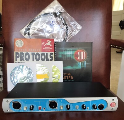

It's a DigiDesign Digi 001 card. Came with an external box. It is a sound card / interface. Useless without the external box, but they're available on eBay. The cables on the otherhand are hell to find.
Review :
It's the sort of card that you would find in a lot of G4s, as many G4s were used as part of a sound production setup. Not rare really.
Got it. I bought the g4 for this card. I paid $50 and the power mac works.
