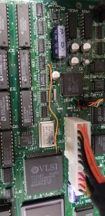

Got my first SE/30 this week and have been looking over the traces after getting the battery and caps off the board. I have a questionable pin on UE10 that I believe is pin 10. The schematic shows this line connecting to something off screen. Can someone help me find a test point to check for continuity from this pin in the picture? Also have a question on the same schematic file (SE30_P7.GIF). I appear to have two broke lines on UC12 Pin 1 and 2 going to RP2 pin 18/17. This schematic shows a break in those lines. Is this a mistake on the schematic as I don't get continuity from these two test points, but I do get continuity from RP2 18/17 to R42 and R43 on the back of the board.
