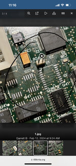

Mystery IIsi that chimes, but has no video, and won't boot!
I also had the problem that the start sound was fine but the computer didn't bring up a picture onto the monitor and didn't boot. The reason was bad contacts (oxidized) on the video controller chip. New/re-soldered and now everything is good ...

When you say "video controller chip" you're talking about the RBV chip at UA3?

I've got a IIsi that just started doing this after I recapped it. ugh. Honestly I did also do an isopropyl bath as well. I wonder if I got some corrosion slurry to form under a chip in the process.
