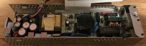

So, I guess it's most likely to be the PSU (or. a fuse?). It's never been recapped. I took the lid off and powered it on, but the fan didn't go. Rats I didn't even check if it was a mains fuse that failed. Anyway, here's what the inside of the Performa 400 looked like:
It has an ethernet PDS card (10-base T). The PSU seems OK.
No caps appear to be bulging, doesn't seem to smell. I've just checked the internal PSU fuse and that seems to be OK. I guess the next test is to power it and check the voltage outputs? Do I need to apply a load? If so, where?
