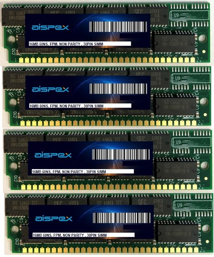

This is what I'm planning to get for an SE/30...anyone have any experience with it?
I bought them from that seller in the past. They are not low profile enough. Unless placed solely in the 4 rows closest to the ports at the back on the se/30, they will hit against a protrusion in the metal frame as you slide the logic board back in, and possibly break a RAM socket clip, as happened to me.

I have had no issues with 8 of these inside 2 Macintosh SE/30 computers and 4 each inside two Macintosh IIsi computers. I heard of some people with issues of them hitting the Chassis inside a Mac SE/30. Perhaps there are different chassis versions, idk.
