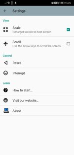

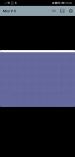

In the android version, tapping in the black void off the emulated screen shows extra things including a button for a menu. Interrupt and Reset are in that menu.

Ah thanks! I failed to interpret those old icons … answering my own question for the record: swipe left with two fingers to get the “Insert Disk” window. Then tap the interrupt symbol:
