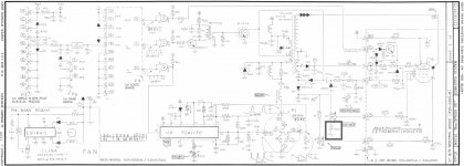

The 470k resistor that goes between the cut off potentiometer and ground had burnt out. Swapped for a replacement 330k (only one I had on hand, but the difference can be offset by the potentiometer) and we have a happy mac without scanlines!
Also including the bomarc schematics with the resistor that failed highlighted if anyone else has this issue at some point
