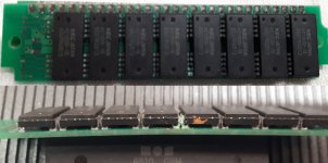

And a lot of damage on RAM, as the image below shows:
So I bought 4 new sticks of 1MB of RAM.
