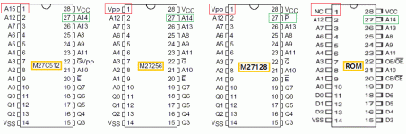

Regarding the above, I must correct an error. The ROM that I replaced 3 years ago was the LO ROM. And it wasn't with a UV Eprom 27C128, it was with a 27C512. The 27C128 and 27C256 are not Pin-to-Pin compatible. I leave a small comparison that I made between the different Eprom.
I think it is possible to use Eprom 27C128 and 27C256, but it is work for another day.
