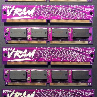

which VRAM SIMMS should I look for for an upgrade?
I have 832x624 256 colors

For VRAM I'd start by browsing eBay, but Siliconinsider makes very pretty new ones if you're interested.
