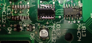

The three 74HC logic chips, right? In my case the middle one failed without any visible signs of corrosion. I even desoldered it, cleaned up all the traces and re-soldered it down. I am sure it was killed by cap goo.
The chips looks to be fine, little to none corrsion.
Is it just me or are the caps at C10 and C13 still the originals? Also, you might consider replacing the axial caps as well, although they are less crucial than the SMD parts.
74HC74 and 74HC132 is now changed for new. The chips I got gold of is ”74HC74D and 74HC132D” I hope that does not matter?
But still, I have the same problem as before :/
