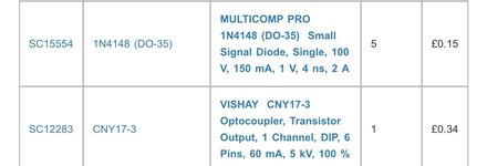

For the sake of a few days wait to when I can go to the component shop I'll leave it till then so I can replace dp3 and dp4 with new 1n4148 and octocoupler with a new cny17-3 as it seems a terrible idea to leave these and risk damaging the crt.

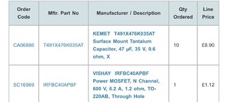

As there was initially no D.C. voltage I replaced the mosfet with a IRFBC40APBF, controller with a ebay special tda4605 and octocoupler with CNY17-3 and signal diodes with 1N148. By the time I got to cp4 and cp5 my component tester had popped and broken so I replaced these with general purpose caps which weren’t 30 years

logic board caps were replaced with kemet tantalum as per recap a mac.

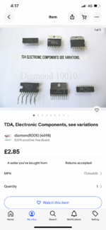

I couldnt find tda4605 it seems to be mega discontinued instead I got a china special off ebay locally(though I could have gotten from aliexpress) with the correct chip markings, the mosfet was equivalent and the diodes are general purpose parts anyway.
