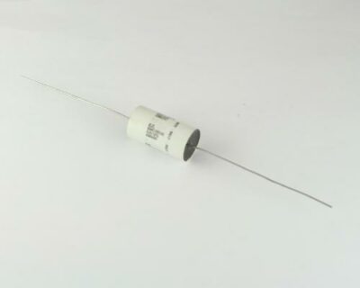

I replaced the capacitor at C1, no change. Felt like giving up at that point. Then I replaced the 4N35 at U3...and it came to life! I'm also getting the proper voltages on both the 5v and 12v lines, and the floppy drive is back to normal. I want to thank all of you for your help during this stressful ordeal. I hear the floppy drives tend to go bad with age (eject seize up, broken gears), so I don't even plan on using it. I just ordered a Floppy Emu Model C Bundle from BMOW and a keyboard cable for the M0110 keyboard which I need.
