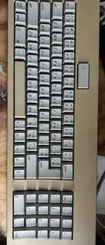

Ive been collecting Vintage Macs recently as a side hobby. Recently I got another Mac SE in that originally belonged to someone who spoke Japanese. The system was upgraded several times with a 1.4mb drive, 40mb HDD and the extra benefit of this Mac is that it has a Sonnet Allegro Accelerator with 16mb of Ram.
Main question here is,
1) The unit has System 7.1J on it, how can I change language settings or does it need system 7 reinstalled with the English version.
2) Is System 7.1J a version that's difficult to find and should I upload it for others to get ahold of before proceeding with whatever I need to do
Thanks in advance to those who respond to this thread
