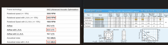

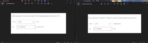

Again I'm probably stinky BUT -
Stock is 21.6 Pascals
Noctua 21.3 Pascals
I can't see 0.3 pascals being a big deal. I also cant see a 35 year old fan producing 100% performance.....
Not trying to be obtuse here but I do my homework ;) The Hard drive isn't going back in. Also having them on molex means a second can be added if necessary.
You fit the NF-A6x25 FLX in there?
