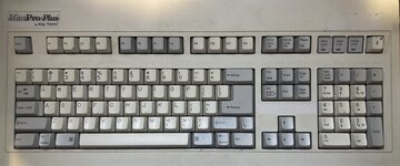

If you can find a MacPro Plus keyboard by Key Tronic, it will work with a Mac Plus, any Mac with an ADB port, and (with the help of a USB adapter like the BMOW Wombat or a Griffin iMate) a computer with a USB port.
