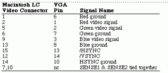

Mac LC and DB15 to VGA adapter problem...

Hi, I'm back after a long break. The struggle with LC continues. Computer is working, but as you can see in the pictures, the screen has vertical stripes and the image sometimes streaks. All capacitors have been replaced, the board has undergone a bath in IPA and cleaning. Two tracks were damaged cause capacitor leaked out. I have repaired it. Can I ask for advice on what else to check or do ?
