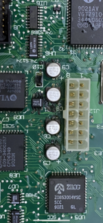

Well, i being that this was still early in my soldering learning curve, will check for bad traces. This board I bought last spring and it was nasty.. two broken traces just in this area, plus i had to buy a new regulator and eaten pads.. so could be anything.. have a strong magnifying glass now to check for more broken traces. Board works good.. just wont mount the floppy
