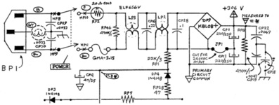

I think there is one salient difference between running off of an isolation transformer and running off of the mains, which is that the earth pin will be connected to nothing on the isolation transformer, while on the mains it will be connected to neutral (usually) at a point near your breaker box.
I think it will be useful to work from a theory that the connection between earth and neutral leads to the problem you're seeing here. A problem with the mains input side seems likely to me, but I'm not expert enough about power supplies to suggest what it could be.

Mains earth *seems* to only be used on the power input section (see schematic snippet attached).
CP19 and CP38 (XY class) have already been replaced.
I'll go ahead and pay close attention to the other components in this part of the schematic.
I also didn't pull the components in this area to check and clean underneath them, so there may be some electrolyte underneath causing problems.
Mains earth is connected through some kind of choke? Is this just the ferrite bead?
CP30 is between live and earth.
CP29 is between neutral and earth.
Components between live and neutral are RP46, LP3, CP16, LP2, CP28, and the bridge rectifier.
CP19 (replaced) couples the board ground to earth via CP38 (replaced).
CP22 couples the DC output of the bridge rectifier to earth via CP38 (replaced).
RP18 is across the DC output and common of the bridge rectifier.
