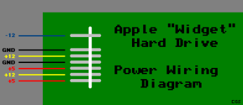

Looking at the drawing in the post above, for the voltage pinouts of the hard drive connector - I have now the following starting from top to bottom
-12 volts - sun remarketing drive does not use this !!!! There is no actual pin on the sun remarketing board to connect to
GND
+12 volts
.25 volts !!!!!!!!!!!!!!!!!!!!!!!!........ this is the problem....... opened the PSU, cant see anything wrong
+12 volts
+5 volts
Am tempted to disconnect the non working 5 volt line , and join it to the working 5 volt line. But tracing these back the the PSU they come from  completely different lines from the power supply.
I imagine these 2 x 5 volt outputs are not the same. One is probably more controlled than the other - i dunno .. just guessing. But its probably a bad idea.
Come on people.......... I am so close to finally seeing this lisa fully working.
This sun remarketing drive apparently has the Lias OS installed on it. Waiting 2 years to see the Lisa OS
An update on this for anyone with the same problem
pin 3 ( the one that gives me .25 volt) is a 'drive censoring line'. Apparently this line reports back to the PSU that the drive is happy!!. It is not needed to power up the sun remarketing drive.
Once the drive is powered up and spinning this pin 3 goes to 5 volts!!!.
Cant say this is all accurate, its just what I have found.
