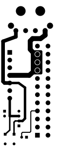

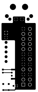

Started laying out the PCB this morning, not sure how long it'll be until completion because kids and life stuff.
