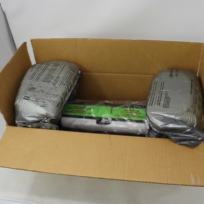

So... I would hope I can use a typical HP LaserJet II or III fuser with this?
Would this work?
Or this one?

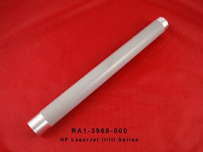

If I rebuild it, what part actually failed?
This?
Or this?
Strange looking bulb, think it's toast.
Think I'll try and get a new bulb.
No continuity at all.
Would this work?
Or this one?
This?
Or this?
