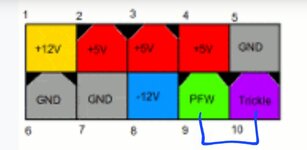

Hi everyone, I just recapped the MB and PSU from a IIsi. With the PSU out of the computer, I have a nice 4,96V from the 5V stand by line. How can I start the PSU without putting it in the computer. Which pin of the 10 pin connectors tells the PSU to start ? I want to do this before putting the PSU in the computer so I can check the output voltages.

I believe you want to apply the 5v to the /PFW pin. It needs to be kept connected (the logic board would latch it)
Note that PSUs often don't show the correct voltages when not loaded, and sometimes won't even start without a load.
The best, and only reliable way, to do what you're trying to do, without connecting the board, would be to use a dummy load.
Thanks, when plugged, my PSU shows only 5V on pin 10, which seems correct as this pin is the 5V stby line. What does the motherboard do with this 5V to tell the PSU to start ? (applying this voltage elsewhere, shorting, .... ) I can put a dummy load on the 5 and 12 volts lines if necessary, but I first need to start this PSU.

I said above?
I believe you need to connect the 5Vstby to /PFW *and* have enough load on the normal 5V and maybe also the other lines as well
Ok, I understand now how it works in detail compared to ATX PSU. It's "just" a simple link from pin 10 to 9 (with resistor ?), to power this PSU.
Unfortunatly, when checking, I link pin 10 & 9 with a 1 k resistor and something blew inside the PSU (not instantly, but after some times). Those PSU are really complicated to rebuild. I'll switch for an ATX PSU ...
