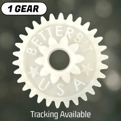

Yeah, sounds like the gear failed.
You'll want to find a gear for an 800k floppy and fit it.
Perhaps this :
Or this :
I don't have experience with either, but you'll want to clean and lubricate the drive at the same time. There are several videos on how in YouTube.
Perhaps this :
Or this :
Excellent. Thank you for the confirmation that was the issue and for the links. I'll get those ordered and hope for the best;)
