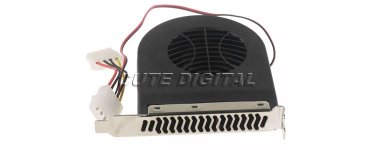

Bunsen's idea of using a little fan set up on an available slot opening might also work.
http://www.ebay.com/itm/5pcs-Small-Blower-Fans-5015-50X50X15MM-DC-12V-2Pin-Computer-Case-PC-Cooling-Fan-/191697895127?hash=item2ca215bed7:g:r0EAAOSwuTxWAPcZ

yeah i was originally thinking the PCI card slot fan as bunsen suggested... the only problem is there is no PCI slots.  and no way to mount that... how ever...  there is rectangle shaped holes/ports in the rear case, That I think you could cleanly place the mouth of the blower that i suggested into. that way we are pulling the hot air from inside the case and blowing it outside.
