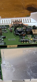

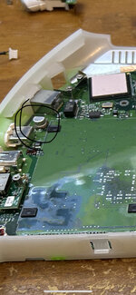

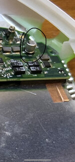

I have recapped my 8 ibook clamshells. The supercap leaks on these, so might want to take a look if its apart
Howdy! I've done the super capacitor on a few iBook clamshells to ensure NVRAM is saved and avoid PMU issues, but I didn't realize those other 2 caps needed to be replaced. Have you seen leakage from them? What issues have you seen as a result?

Other caps didn’t show signs of leaking but changed everything while in there. Used organic polymer
