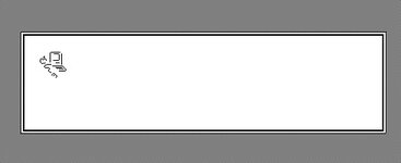

I watched the video some people modified the starting screen of the Maikin Tower ~ Does anyone know how to do it? thank you very much

They probably just removed the "Welcome to Macintosh" string from the system file using ResEdit...
If you want to give the startup sequence a different look, create a StartupScreen file and put it inside the System Folder :)

What is the format of StartupScreen? I don't seem to see this file in the system folder, is it made by myself alone?

system FILE, not system FOLDER, there is a file in the system folder called System, it has a suitcase icon
edit: I didn't read all the way, I think you make it yourself

It's a file you can create yourself, using apps like ResEdit or MacPaint. It basically is a file with a 'PICT' resource with ID 0. I attached an example for you. Just extract it and put it in your System Folder.
I believe there were two StartupScreen formats supported:
  1. A file with a PICT resource in it, ID = 0
  2. A MacPaint document (which is not the same thing … MacPaint files are compressed bitmaps, not PICTs)
However I can’t actually immediately find this documented anywhere, would love if anyone can confirm. I swear I did #2 when I was a kid.
Edit: it looks like the ROM indeed does kind of the above, in that order, except option #2 is a straight uncompressed bitmap, not a MacPaint file? Definitely not what I remember …. https://github.com/elliotnunn/mac-r...4362d70d1e0259aef65ab814f/OS/StartMgr/Boot3.a

I found that the starting screen of the production can only be full screen, and the 7 system can not be a full screen. The system below 7 must be full screen

Ive been trying to get this to work with system 6.0.8 running in mini Vmac and it's always just a black screen and then the extension and control panel icons run across the bottom of the black screen. Anyone have any ideas?
Not really, just a personal anecdote that I never, ever got this to work on any (real) Mac I tried it on back in the day. Not even with a file I downloaded somewhere that was supposedly a sample that worked.
I guess there must be some circumstances under which it does, but I never found them.
I tried everything and even downloading working ones others made and could not get it to work. Must have something to do with mini Vmac emulator and or system 6.0.8
I started off with the one that's bundled with Beyond Dark Castle, and just edited the image.
The one that came with the vMac (not Mini vMac) emulator boot floppy also works.
