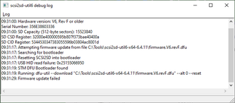

I can't get either of my SCSI2SD v6 boards (one is rev F and the other is 2020d) to update the firmware. In both cases, I get an error message "firmware update failed". That's not a very descriptive or helpful error message. The log isn't that helpful either:
scsi2sd-util6 log: 20:08:43: Attempting firmware update from file C:\scsi2sd-util6-x64-6.4.11\firmware.V6.revF.dfu 20:08:43: Searching for bootloader 20:08:47: Resetting SCSI2SD into bootloader 20:08:47: USB HID read failure: 0x1fe48edc030 20:08:50: STM DFU Bootloader found 20:08:50: Running: dfu-util --download "C:\scsi2sd-util6-x64-6.4.11\firmware.V6.revF.dfu" --alt 0 --reset 20:16:16: Firmware update failed
The DFU-UTIL output isn't much help either - except maybe that last line "No DFU capable USB device available" - except in the log above it says it found it. Why can't DFU-UTIL find it?

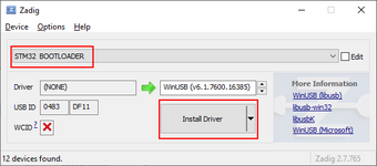

You might try using something like Zadig to verify that the correct drivers are being selected when it enters DFU mode, and change it if necessary.

I was having the same issue with a 2020 scsi2sd v6. Installed the STM32CubeProg utility from STM and noticed that device manager now correctly detected the dfu device (on Win11 latest updates). My guess is the drivers on the scsi2sd site are incorrect. I have updated to the latest firmware and the scsi2sd util shows the correct/new version.
I ran into the same issue and managed to find a solution (for Windows 10 22H2)

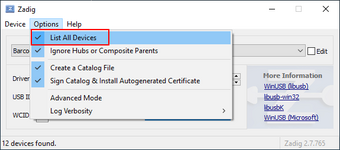

3) Launch Zadig and enable "List all Devices" under "Options"
4) Install the driver for the "STM32 BOOTLOADER" device
5) Run the firmware upgrade again. It will work now.
