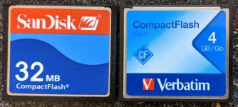

I got in the mail today two new compact flash cards. One was a 32GB SanDisk Extreme card rated at 120MB/s and UDMA7. The other was the exact same card as Gruz used in his YouTube video - a Verbatim 4GB with no bragging rights at all (at least none printed on the card or the packaging.
The high quality SanDisk didn't work. Same problems as with all the other cards (except the 32MB card).
Guess what happened with the almost-generic Verbatim 4GB card? It worked! As soon as the Performa booted, it recognized that there was a blank drive attached and asked me to name it and initialize it. I did, and BOOM: working compact flash drive! I did NOT use the Drive Setup tool. In fact, the Drive Setup tool was absolutely no help at all. If the OS doesn't recognize the drive and prompt you to initialize it, Drive Setup isn't going to help either.
So... after giving up on it and forgetting that I hadn't received my Amazon order of two additional cards until they showed up today, the card that works is the one I thought was least likely to work! (I've never had good experiences with Verbatim branded media.) I should have trusted in the Gruz!
For those just joining us, here are cards that are known to work and not work:
WORKING CARDS:
Cards that definitely do NOT work:
