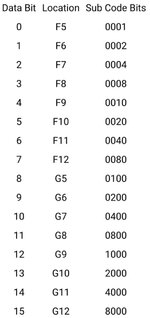

Found a very nice week 29 128 today on marketplace here in Atlanta. She told me it wouldn’t turn on. Of course, it does but the only code I’m getting code is “041CE0”. I’ve been trying to use the the website to decipher it and the only thing I think I can come up either is data bit 12 location G9.
Is this correct and if so is there any more to the “CE0” part of the code?? Ugh I’ve never been good at figuring these codes out. Anyway, any help would be much appreciated.

If I understand it, 1CE0 is 0001110011100000 so you're reporting errors with data bits ... 5, 6, 7, 10, 11, and 12??
Someone check my working, did I get get it backwards because of MSB / LSB?
Just installed a chip in G9 and new code is 040CE0. So I fixed the “1” now to figure out the rest. Thanks for all y’all’s help, I’m going to try and make heads or tails or the previous chart.

Surely try replacing chips corresponding to 5, 6, 7, 10 and 11 like the error code says?
