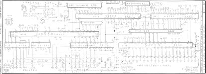

Looks to me like you got lucky - most of those pads appear to be NCs per the schematics. The rightmost upper pad seems to be the only one that needs to be fixed, and there's a handy trace you could use as a basis to repair.
You probably want to verify those vias to the right, they tend to collect cap juice and can eventually lose connection too.
Not entirely luck. The NC pads always seem to be less securely adhered. Maybe just the fact that they don't have connected trace that runs under the solder mask.
Yeah, luck more from a perspective of only one fiddly repair rather than four.
That being said... I'll take lost pads any day of the week as compared to lost leads. Last week I had to carve away at an ASC that had a corroded leg break until there was just enough copper I could solder to it.
