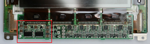

So I things with the 180C have been going...... bad.
I recapped the original LCD and the distortion is gone, but now a row of pixels on the top of the panel is dead. I think my new soldering iron was a big part of the problem. The digital temperature setting was extremely erratic and seemed to fluctuate between "Not hot enough to melt and snow man in July" and "Hot enough to somehow melt the sun" at random. Needless to say that thing got sent back.
It probably kicked up to a high temp and damaged the ribbon cables to run from the PCB to the panel itself.
I found a apparently NOS panel from Visual Information Services Ltd. and ordered it a couple weeks ago. I expected it to probably have dying capacitors, new or not it's still 17 years old, but I could always find a professional with steady hands and proper equipment to recap it.
The new panel came in yesterday, I hooked it up to see what kind of shape it's in annnddddd...... It's worse. It's so much worse. The artifacting/distortion that my original screen exhibited is there, so clearly the caps are bad
But the way they stored it allowed electrolyte to leak into the ribbon cables and mess up the contacts, leading to several lines of dead pixels.

Slightly resurrecting here, but curious how everything ended up.  I just started playing around with a 180c I’ve had for a while but haven’t used much.  Works great except for these artifacts which tend to appear in horizontal streaks alongside any large white areas on the screen (moving around as windows/menus appear).  I think it looks similar to your issue (but mine looks worse based on your pics).  I assume this is likely to be fixable with a recap.
In the end, the project has been shelved for a while. My old car had some major structural failures and needed to be replaced, so that's been occupying my time and wallet.
I did get a partial refund from VIS for that defective screen. They wouldn't issue me a return shipping label, and local couriers wanted over $70 CAD to ship it back to them. So in the end, I got a refund for the cost of the LCD but didn't get a refund for the shipping. I get to keep the defective screen. But....... Honestly the only thing I can really use it for is to salvage out the backlight tubes
As things stand now, I'm still looking for another LCD and then I'll try to seek out someone with the right tools to recap it. In the meantime, I did snag a brand new rear lid that's never been used. I'm going to reinforce the hinge mounts and hope they hold up for a while.
As far as your screen goes, yes, that issue is likely caused by bad caps. Those horizontal streaks appeared on my LCD in exactly the same way & in the exact same scenarios; and went away after I recapped it. Had that crummy soldering iron I bought been a bit more stable with its temperatures, I likely wouldn't've had any further problems.
But I digress, recap the screen properly and it'll look good as new. While you're at it, don't forget to recap the brightness control board. Mine had some leaky caps that made a horrendous, fishy smell every time the unit was turned on. And you absolutely don't want that electrolyte shorting out such a high-voltage part. Another member here had that happen on a 16x PowerBook and it completely fried an IC on the screen.

After sitting on the 180c for months after a failed screen recap, I had an epiphany:
Over a decade ago, my Nintendo Virtual Boy had rows of dead pixels which I fixed by tossing the display assembly into an oven for a bit before pressing down on the the ribbon cable.
If it was good enough for the Virtual Boy, I reasoned it might be good enough for the 180c’s screen.
20 minutes at 200 degrees completely fixed the damage that had been done during my recap attempt. No dead pixels. Just pure, 256 colour bliss.
